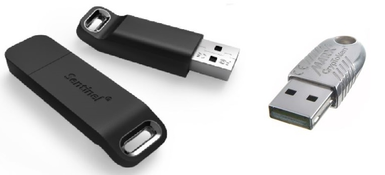

2. If the software is using a USB Dongle based license
  1. Install any required controller drivers
  2. Run the CMM-Manager installer on your computer.
  3. Follow the onscreen instruction to finish the installation; Restart the computer.
  4. Move the dongle to the new PC.
  5. Go to Step 5.
