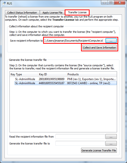

  2. Switch to the “Transfer License” tab.

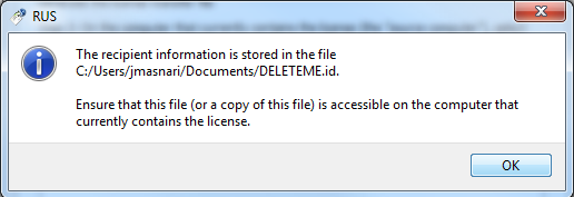

  3. Click the browse […] button and browse to/enter a path where you want the information to be saved.
  4. Click the [Collect and Save Information] button.  You will need to access this information later, so make sure you save it in a location that will be easy to find.
  5. Click “OK” on the next screen.
  6. You will need to transfer the recipient information file you just created to the computer, which currently has the soft lock installed.  You can do this by flash drive, e-mail, or whatever method is easiest for you.

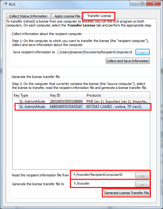

  3. Click the browse […] button for ‘Read the recipient information file from:’ and browse to the file you saved from the temporary computer.
  4. Select the Soft Lock you want to transfer/remove by highlighting it in the list.
  5. Click the browse […] button for ‘Generate the license transfer file to:’ and browse to/enter a path where you want the transfer file to be saved.  You will need to access this information later, so make sure you save it in a location that will be easy to find.

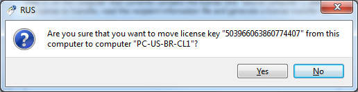

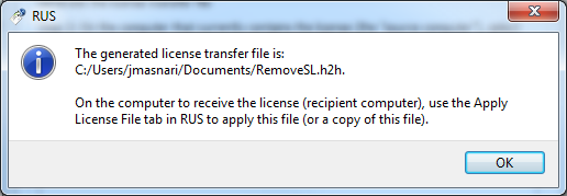

  6. Click the [Generate License Transfer File] button.
  7. Click “Yes” on the next dialog.
  8. Click “OK” on the next dialog.
  9. The Soft Lock has now been removed from the original computer and placed in the transfer file you created.  You will now transfer this file to the temporary computer (by whatever means you prefer).

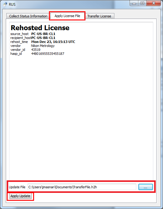

  2. Switch to the “Apply License File” tab.
  3. Select the transfer file you created from the old PC.

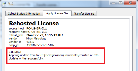

  4. Click the [Apply Update] button.
  5. You should receive a message saying, “Update written successfully.”
The temporary Soft Lock transfer is complete.
  3. Click the browse […] button for ‘Read the recipient information file from:’ and browse to the file you saved from the final computer.
  9. The Soft Lock has now been removed from the temporary computer and placed in the transfer file you created.  You will now transfer this file to the final computer (by whatever means you prefer).
  3. Select the transfer file you created from the temporary PC.
The final Soft Lock transfer is complete.
