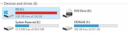

Not enough available disk space on the PC
Solution:
  1. Clean the drive to free up space
  2. Re-run the installer as Admin.

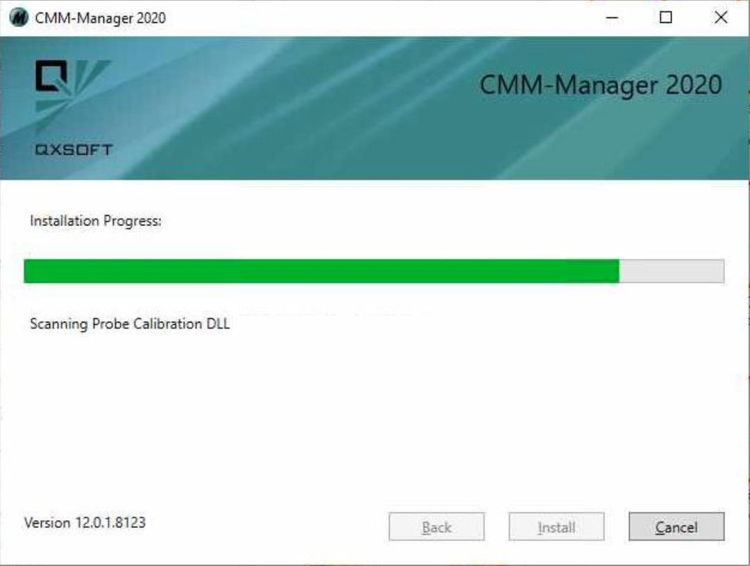

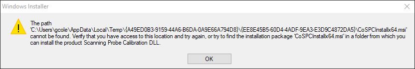

Cannot install the Renishaw Scanning Probe Calibration module
It is possible that the existing IT policy may prevent the installation of the SPC module.  A s a result, other subsequent packages such as PDF Writer may not install and cause issues when attempting to  save to PDF .
Solution:
  1. Reboot the PC
  2. Disable any 3rd-party anti-virus
  3. Launch the Windows Command Prompt as Admin.
  4. Install the standalone SPC MSI file with the force repair/install option.
    1. i.e., msiexec.exe /fa CoSPCInstallx64.msi
    2. for more details, refer to Command-Line Options

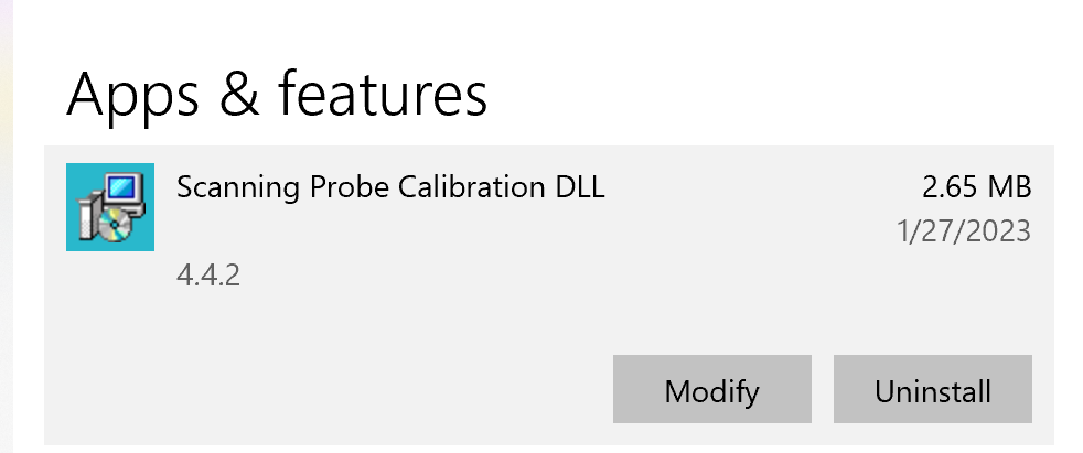

A newer version of Scanning Probe Calibration module has been installed
Solution:
  1. Reboot the PC
  2. Open Windows "Add or Remove Programs" or "Apps & Features"
  3. Find and uninstall Scanning Probe Calibration DLL
  4. Re-run the CMM-Manager installer as Admin.

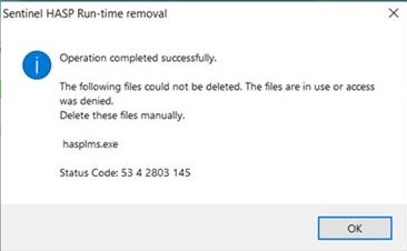

Sentinel HASP Run-time removal error
Solution:
  1. Reboot the PC.
  2. Go to Windows Services (Start > Services).
  3. Find "Sentinel LDK License Manager", and select Stop the service if this service is present and running.
  4. Open File Explorer and browse to folder "C:\Program Files (x86)\Common Files\Aladdin Shared\HASP"
  5. Delete file "hasplms.exe" in this folder. Note: You may need admin right to perform this action.
  6. Re-run the CMM-Manager installer as Admin.

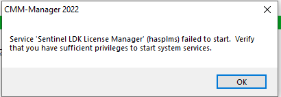

Service 'Sentinel LDK License Manager' (hasplms) failed to start error
Solution:
  1. Reboot the PC.
  3. Find "Sentinel LDK License Manager", right click and select Start. If the Start option is greyed out, click Properties and change Startup type to Automatic first, and then Start the service.

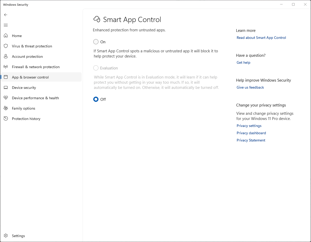

Windows Smart App Control settings
Windows Smart App Control (SAC) can block the installation of software if it flags an application, installer file (.msi or .exe), or background script as untrusted, unsigned, or potentially unsafe.  Disable this Windows setting temporarily as shown below to resolve some blocked installations.
