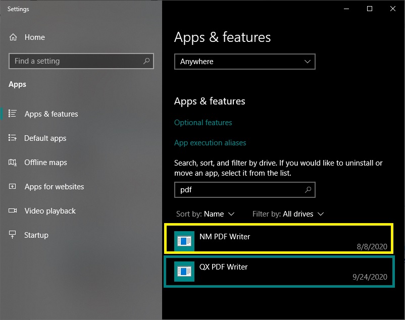

  2. Check that QX PDF Writer is installed (see Add/Remove Program list). If not, reinstall CMM-Manager with elevated privilege and A/V disabled (see fig 1)

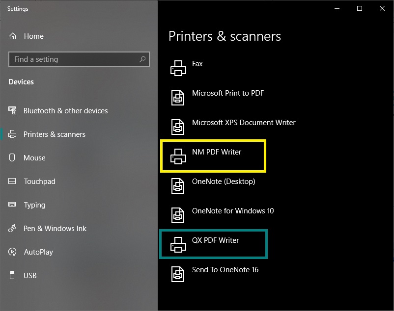

  3. Check if QX PDF Writer is on the Printer list, if not, reinstall CMM-Manager with elevated privilege (As Admin) and with Anti-Virus software disabled.  (see fig 2)
Figure 1 - PDF Printer App
Figure 2 - PDF Printer
