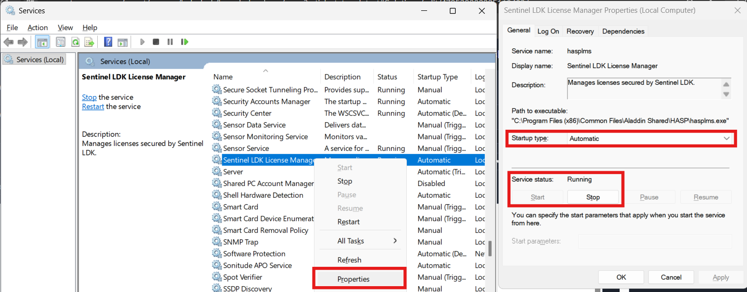

C:\Program Files (x86)\Common Files\Aladdin Shared\HASP\hasplms.exe
C:\Program Files (x86)\Common Files\Aladdin Shared\HASP\hasplmv.exe
