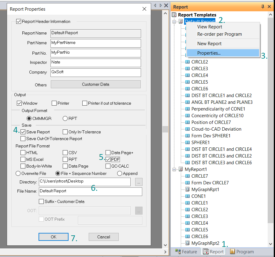

Set Report Properties as follows:
  1. View the Report Database
  2. Right Click on Report Name - i.e. Default Report, MyReport1, etc.
  3. Choose Properties...
  4. Check the Save Report Checkbox
  5. Check the File Format(s) you'd like to save (you can choose more than one)
  6. Enter or Browse to Directory and File Name
  7. Click OK to accept
Report Properties
Note - It's possible to save unique file / folder for each Report in Report Database - i.e. you could save .RPT file for Default Report and .PDF for MyReport1, each to a unique file location.
