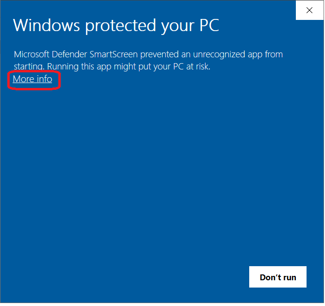

  1. In the case that Windows is preventing the installer, proceed as shown below to allow access
  2. Select "More info" and the below dialog pops up

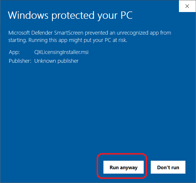

  1. Select "Run anyway"
  2. Follow the on-screen instructions to complete the installation

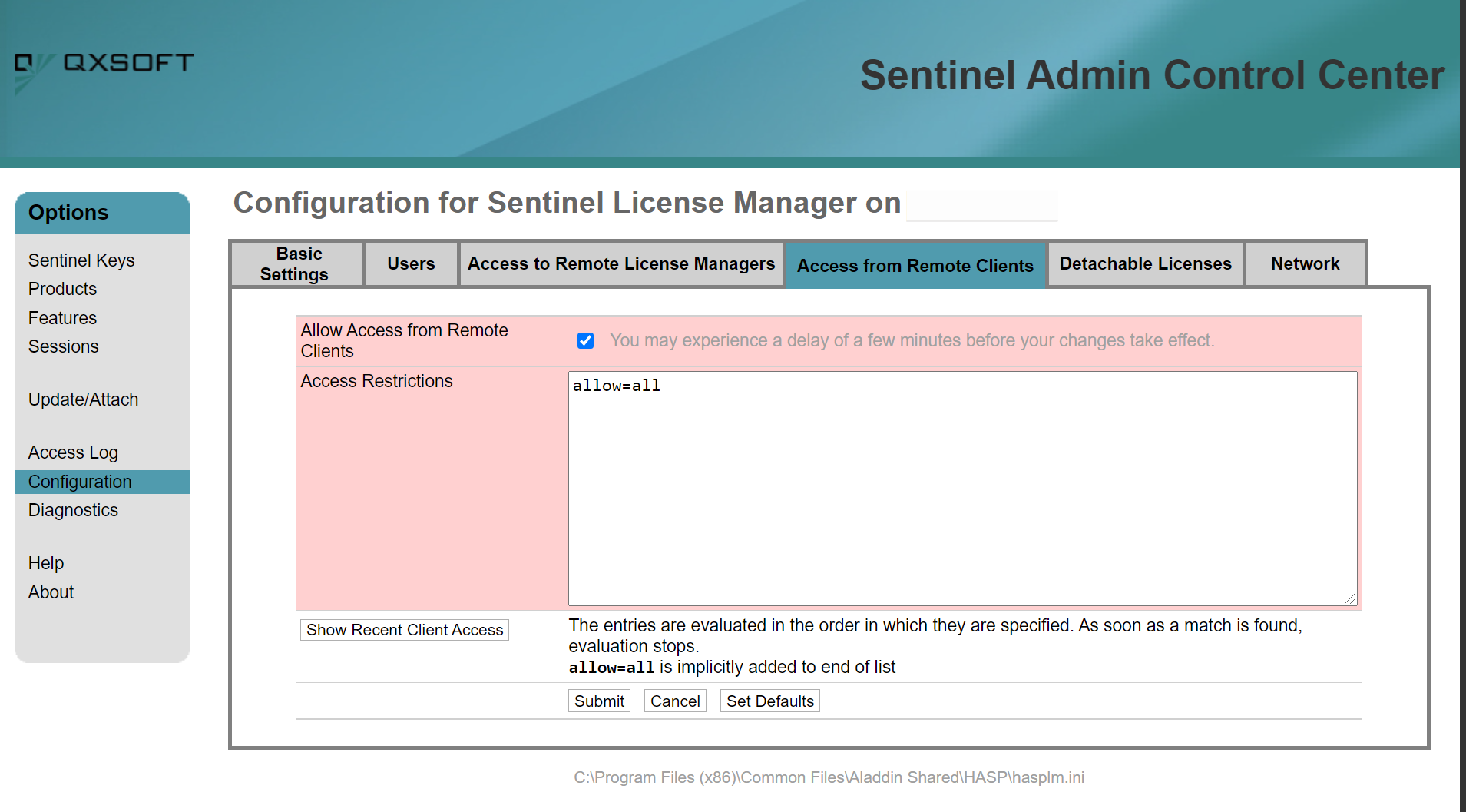

    3. From the Options group (Left side) select Configuration
    4. Switch to the Access from Remote Clients tab
    5. Include the options as shown in the image below:
      1. Check the Allow Access from Remote Clients option
      2. Add allow=all to the text field
    1. Select the Submit button (Note: the option may not stay checked which is normal.)
