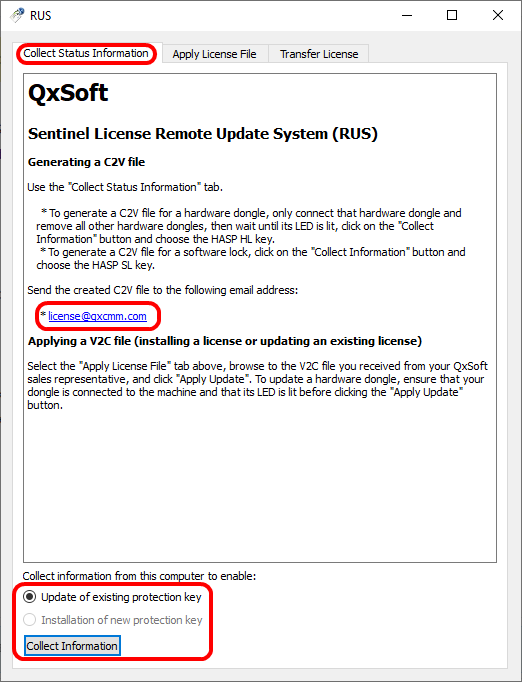

  1. Run the RUS utility - Windows Start Menu > QxSoft, and select "QxSoft License RUS."
  2. Select the "Collect Status Information" tab
    1. Select 'Update of existing protection key' to obtain an update (SSC update, or additional license, for instance)
    2. Select 'Installation of a new protection key' for a new installation or upgrading to CMM-Manager 2020
  3. Click the 'Collect Information' button and follow the prompts to save the .c2v file
    1. You will be prompted to supply a location and filename
    2. If more than one license method exists (a dongle and a pre-existing license), you will be asked to select the appropriate license. HL is a dongle. SL is a SoftLock
  4. Email this file to the appropriate email address indicated in the center of the dialog as appropriate for your area
