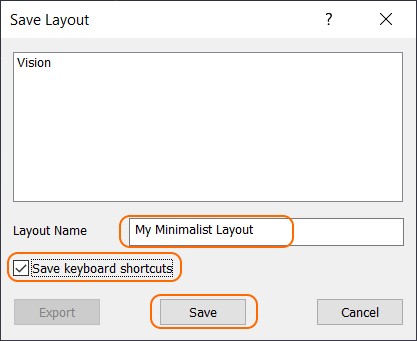

To create a new layout:
  1. Configure the interface to meet your needs.  This can include DRO location, pinned / unpinned windows, window locations, etc.
  2. From the upper right corner of CMM-Manager, select Layout | Save
  3. Enter a name for your layout, and if you have created customer keyboard shortcuts, check the box for Save keyboard shortcuts.
  4. Click Save.
  1. Several different layouts can be saved and loaded as needed.

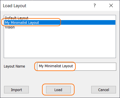

To load a different layout:
  1. From the upper right corner of CMM-Manager, select Layout | Load
  2. Highlight the desired layout.
  3. Click Load.

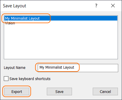

Transferring Layouts
Export from the old comptuer / version of CMM-Manager:
  1. From the upper right corner of CMM-Manager, select Layout | Save
  2. Highlight the layout to be exported.
  3. Click the Export button.
  1. Give the layout a name in the Export Layout dialog and place it in a location you can easily find later.
  1. Repeat for any other layouts to be exported.

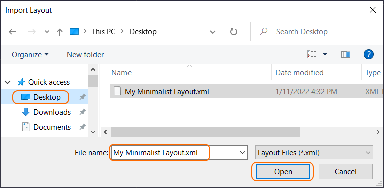

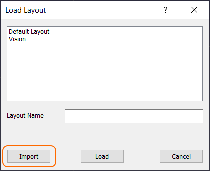

Import the layouts to the new computer / version of CMM-Manager:
  2. Click the Import button.
  1. Browse to the location (thumb drive?) where the exported layouts are.
  2. Highlight the layout to be imported.
  3. Click Open.
  1. Repeat for any other layouts to be imported
