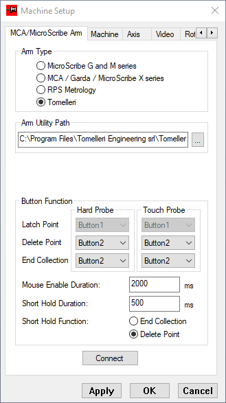

CMM-Manager Machine Setup
  1. Set Arm Type: Tomelleri
  2. Set Arm Utility Path to TomelleriCore software executable (.exe), e.g. "C:\Program Files\Tomelleri Engineering srl\TomelleriCore\TomelleriCore.exe".
  3. Configure button function as needed.
