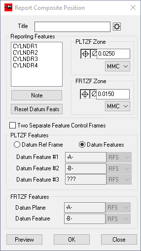

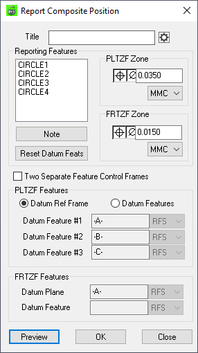

To report a Composite Position of a feature, click the Composite Position icon from Report => GD&T in the Ribbon Bar.
Enter the required information and parameters then select Preview or click OK to complete the operation.
Title (Optional - CMM-Manager 2022 or above):
  1. Enter text here to display items such as Balloon numbers or Key Characteristic numbers from the print in the report.
Reporting Features:
  1. Enter controlled features to be reported. To select, the user can either left-click features in the Display Window or drag- and-drop features from the Feature Database.
Note:
  1. Enter optional descriptive text to be displayed as a note in the report output.

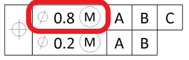

PLTZF Zone:
  1. Type in the tolerance value specified in the PLTZF from the print.
  2. If a material modifier is called out for controlled features, you must output the size of all features before the composite position operation. MMC/LMC option will not be available otherwise.

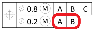

FRIZF Zone:
  1. Type in the tolerance value specified in the FRIZF from the print.

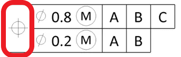

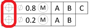

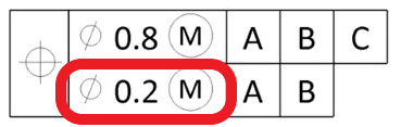

Two Separate Feature Control Frames:
  1. When checked, the Two Separate Feature Control Frames checkbox indicates that the same geometric characteristic will be applied to both the PLTZF and the FRTZF. CMM-Manager will use the FRTZF datum features to report on the relationship of features within the pattern.
    1. i.e. Enable this option if there is 2 separate position symbols for upper and lower control frames.
  1. Clear the Two Separate Feature Control Frames checkbox to verify feature position relative to the datums, as well as relationship between the features.
    1. i.e. Disable this option is there is a single position symbol for upper and lower control frames.
PLTZF Features:
Specify the datum structure for the PLTZF here.
  1. Datum Ref Frame - When this option is selected, the current part reference frame is used for the position tolerance calculation.
    1. Please ensure that the current reference frame represents the datum structure specified in the print before reporting.
    2. Datum Feature #1, #2, and #3 are used to indicate primary, secondary, and tertiary datums on the report.
    3. If the material modifier is called out on datum features, you must output their sizes before this operation. The MMC/LMC options are unavailable otherwise.
    4. Defining datum features here is optional if no material condition exists (the current ref. frame is used for the calculation regardless).

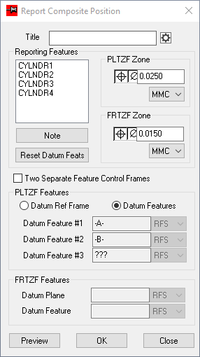

  2. Datum Features - This allows the user to construct the temporary reference frame for the calculation.
    1. Datum Feature #1, #2, and #3 are used to indicate primary, secondary, and tertiary datums on the report.
    2. If the material modifier is called out on datum features, you must output their sizes before this operation. The MMC/LMC options are unavailable otherwise.
    3. Unlike Datum Ref Frame, defining datum features here is mandatory even if no material modifier is involved.
WarningDatum Features option cannot accommodate all possible datum structures; therefore, please revert back to Datum Ref Frame if the error message is received when constructing a datum frame.
FRTZF Features:
Specify the datum structure for the FRTZF here.
  1. Datum Plane - Select the datum plane for the FRTZF. Only plane feature is allowed.
  2. Datum Features - Select the datum feature for the FRTZF.  Plane, cylinder, and line features are accepted.

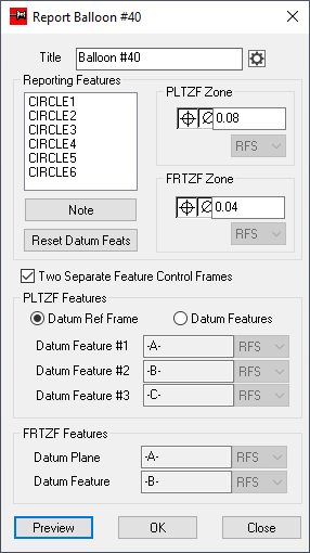

Example #1:
Here is the typical composite position application... Hole pattern.
Assuming that your current reference frame represents the datum reference frame for PLTZF (ABC), the composite position settings required to output the report correctly is below. Please note that diameters of all 4 circles must be reported beforehand for the MMC options to be enabled.

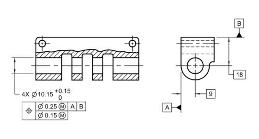

Example #2:
Although less common, the composite position may appear when constraining coaxial series of holes.
Below is the correct report setting for this scenario.
