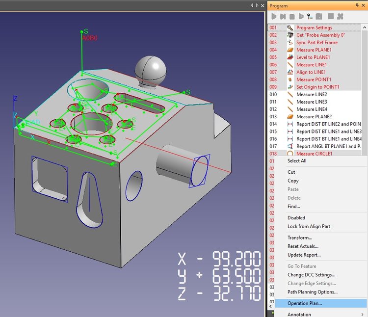

  3. Create Operation Plan by multi-selecting (use Shift or Ctrl keys) Operations from the Program Database, right-click, and choose Operation Plan. Important - Typically, you will choose the first few Operations in the Program, including the main Alignment. See examples for Op 10 and Op 20 below.
- Select Operations 1-17, right-click Operation Plan
- Select Operations 1-10 & 21-38, right click Operation Plan

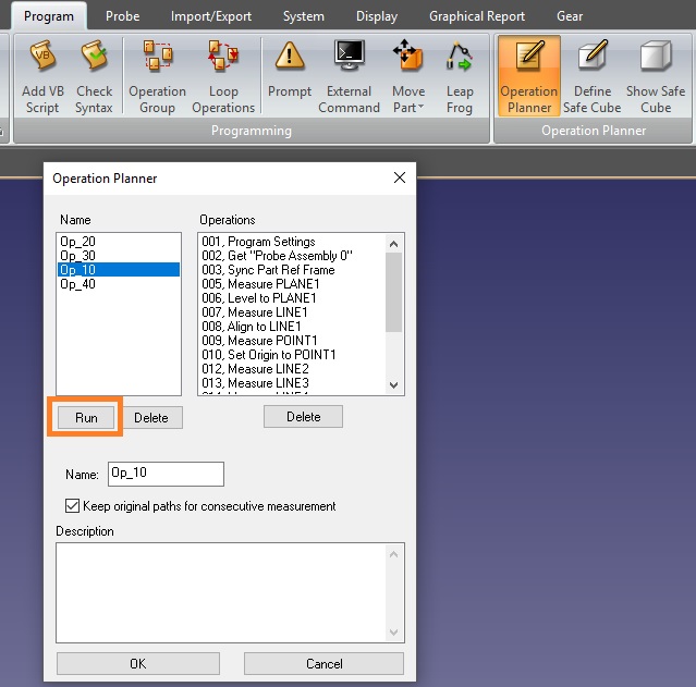

Now you can run each Operation Plan by clicking the Operation Planner button from Ribbon Tab>Program>Operation Planner>Operation Planner. Select the Operation Plan you'd like to run and press the Run button.
Also, notice the "Keep original paths for consecutive measurement" check-box. When unchecked, each measurement operation will include a clearance move (before and after) outside the current Clearance Cube. Checking this box will allow originally planned paths to execute for consecutive program operations, thus maintaining a more efficient probe path. In general, the Clearance Cube is used when any portion of the original program is skipped, allowing safe program execution even when the tip angle is different from one block of the program to the next. The Operation Plan shown below shows that the Probe will move outside of the Clearance Cube as the program skips from Operation 10 to Operation 21.

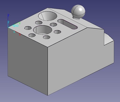

Op 10 - From Operation Plan, choose Op 10 and press the Run button

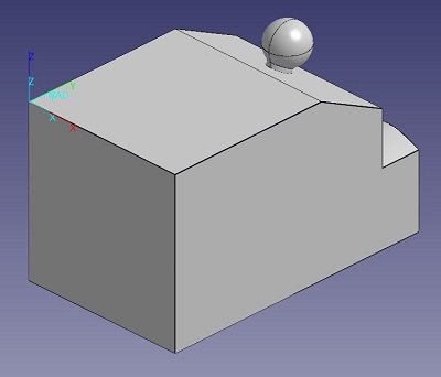

Op 20 - From Operation Plan, choose Op 20 and press the Run button

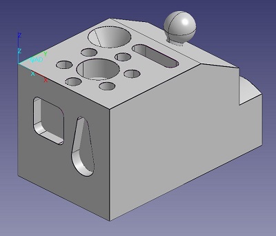

Op 30 - From Operation Plan, choose Op 30 and press the Run button
