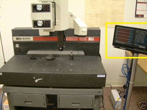

Installation - Sheffield - MP/SMP (Manual)
Sheffield - MP / SMP (Manual)
Models: MP30/35/30-II
Connection:  Serial / RS-232 *null modem
Default settings: 9600, O, 8, 1
Some DCC capable controllers use a baud rate of 19200.
After a change of baud rate from CMM-Manager Machine Setup, the controller has to be restarted.
MP35 requires firmware 12.0 or later for DCC Systems
Sheffield MP - CMM-Manager
