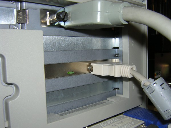

Models: UC-100, UC-200, UC-220, UC-300, UC-330
BRIGHT.sys (ComUC-ISA) needs to be present in the system32\Drivers folder.
