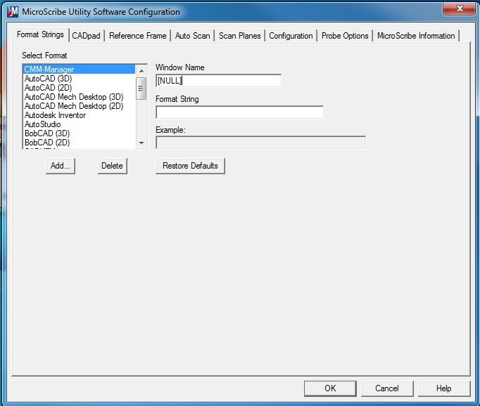

Microscribe G and M users: Configure MUS
  1. Open Microscribe Utility Software (MUS).
  2. Click the button to open Filter settings.
  3. Click Add...
  4. Name the format string "CMM-Manager"
  5. Copy from: <blank Format String>
  6. Click OK
  7. With CMM-Manager selected in the select format list, change Window Name to "[NULL]"
  8. Click OK, Click Yes, Close MUS.
