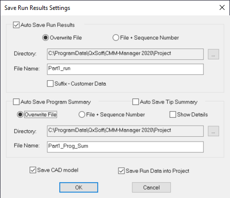

This is likely due to the CAD model missing from the run result file. One way to get them back into the run file reports can be seen below:
Troubleshooting steps to resolve:

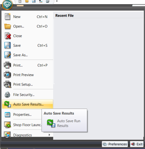

Enable the "Save CAD Model" option in the Save Run Results Settings dialog.
This can be accessed from System Pearl Button (upper left corner) > Auto Save Results.
