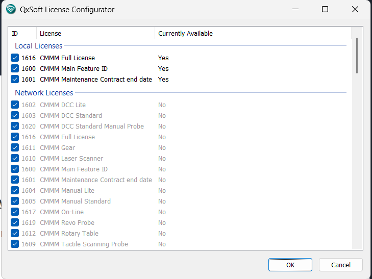

Method 2: Verify the License Configurator for Enabled Options
If the first method fails to resolve the issue or an entire tab is missing (like Vision or Scan) then it is possible the license options were misconfigured.
To verify, open the QxSoft License Configurator.
Make sure that every option that shows as Currently Available also has a box marked to show it is enabled. Click OK if any changes are made.

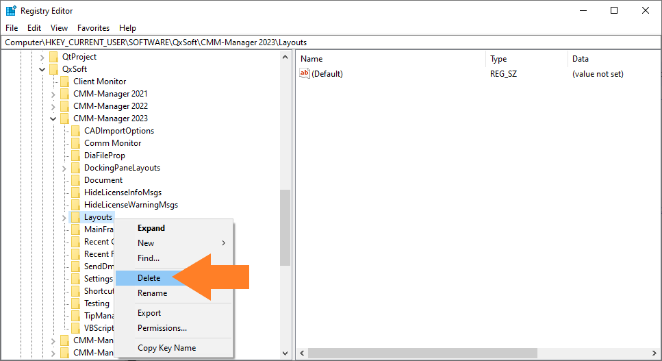

Method 3: Deleting the Layout Key from Windows Registry
Please follow steps below if the above methods fail to resolve the issue or cannot be performed due to the missing Layout button.
Warning
This method requires the manipulation of Windows registry. Deleting or modifying an incorrect key may cause CMM-Manager and/or the Windows OS itself to become inoperable. Please consult with your IT department if you are not comfortable or do not have a permission to interact with the registry.
First, please close CMM-Manager if it is already opened then launch Registry Editor.
Locate Computer\HKEY_CURRENT_USER\SOFTWARE\QxSoft\CMM-Manager ####\Layouts and delete it (where #### is the CMM-Manager version that you are running).
For Nikon-branded CMM-Manager, please delete Computer\HKEY_CURRENT_USER\SOFTWARE\Nikon\CMM-Manager 3.#\Layouts instead.
Now close Registry Editor and open CMM-Manager.
