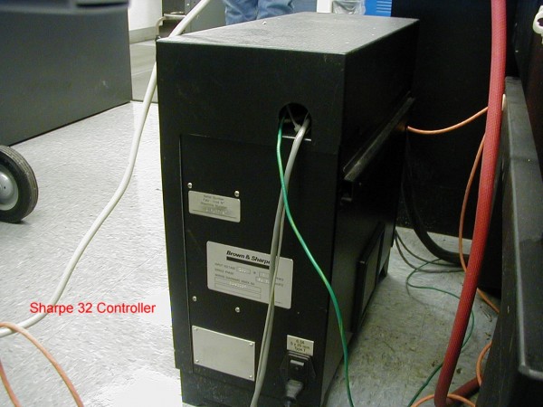

Hexagon (B&S) - Sharpe32 (DCC)
Sharpe32
Default settings:
Com Port Settings:4800, E, 7, 1
Configuration File:
Downl.oad or Syspar.asc file is required. See the install guide for details on the location and usage of these files.
Error Map:
Comp.dat or Comp.asc file will likely be used in previous client software. See install guide for details on file location, usage, conversion, etc.
