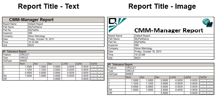

It's possible to replace text in the top of Report Header with your own image as shown below.
CMM-Manager Report Header
From Preferences...
CMM-Manager Preferences>Report
Choose the Image option and then specify .BMP image as shown here...
CMM-Manager Preferences > Report > Header
