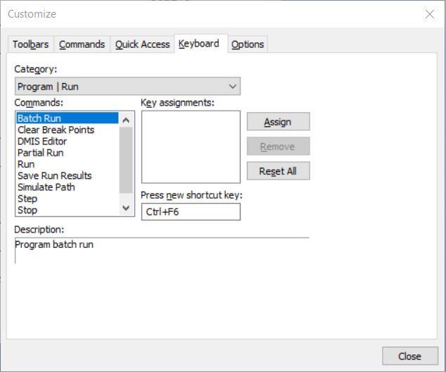

Define a Shortcut
From the Quick Access Toolbar, select Customize.  The Customize Dialog appears, choose the Keyboard Tab.
CMM-Manager Keyboard shortcuts
Select a menu category from the Category dropdown box.
Select a command from the Commands list.

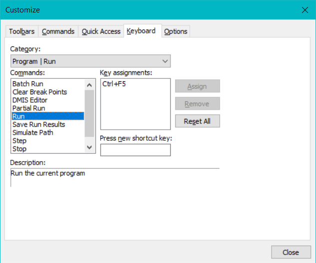

If the command is already defined, it will be displayed inside the Key Assignments section. In the above example, the Program>Run command is defined.
To define a new Shortcut, select a command and press the desired shortcut keys - for example Ctrl+F6 as shown above for Program>Batch Run
Note:  Key combinations work best to avoid conflicts when typing within CMM-Manager

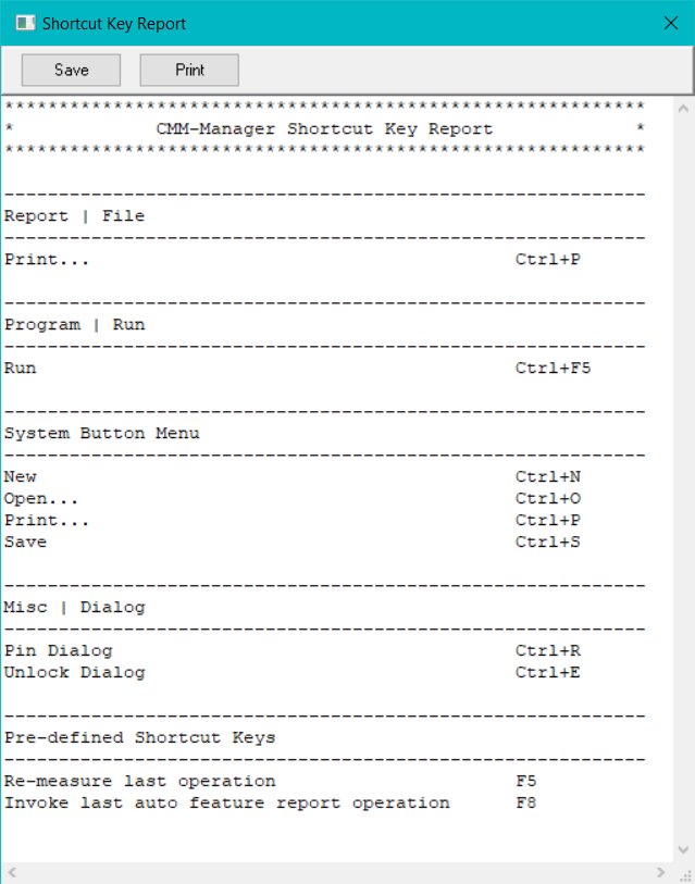

Shortcut Key Report
From the Quick Access Toolbar, press the Shortcut Key Report button to view, print, or save a report of the defined shortcut keys
