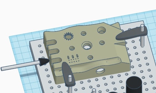

Considering a part and clamps as shown here:
There are several scenarios for adjusting path(s) to avoid clamps.

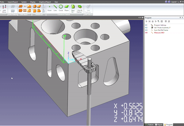

  2. When programming with no CAD, there is really only one option.  The user must add Move Points either when Teaching by Joystick or edit previously created path from the Path Tab.

It's possible to create your own CAD elements by simply joystick / manually measuring the obstacle as simplified geometry.
For example, you can measure just a small cylinder and plane that roughly represent the boundary of the obstacle, then Right-Click the feature(s) from Feature Database and choose Add to CAD...

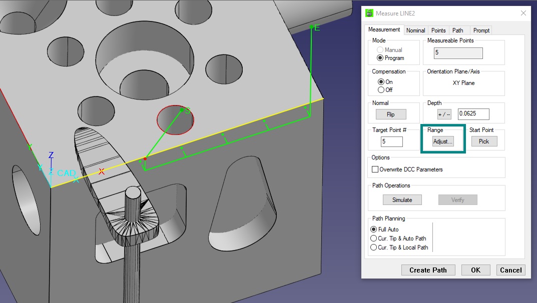

2.  Tools from Measurement Tab - Many times it is possible to adjust the desired path using tools provided on the Measurement Tab.  As before, this method works well with Path Planning, allowing user to move features within program, re-Create Path, etc. all without the barrier of the "Locked" Path.  In the example below, the Range Adjust button was used to reduce the length of the line, thus avoiding the finger clamp.  The tools available in the Measurement Tab vary from one feature type to another, for example a Cone and Cylinder have depth as well as radial options in the Range Adjust interface.

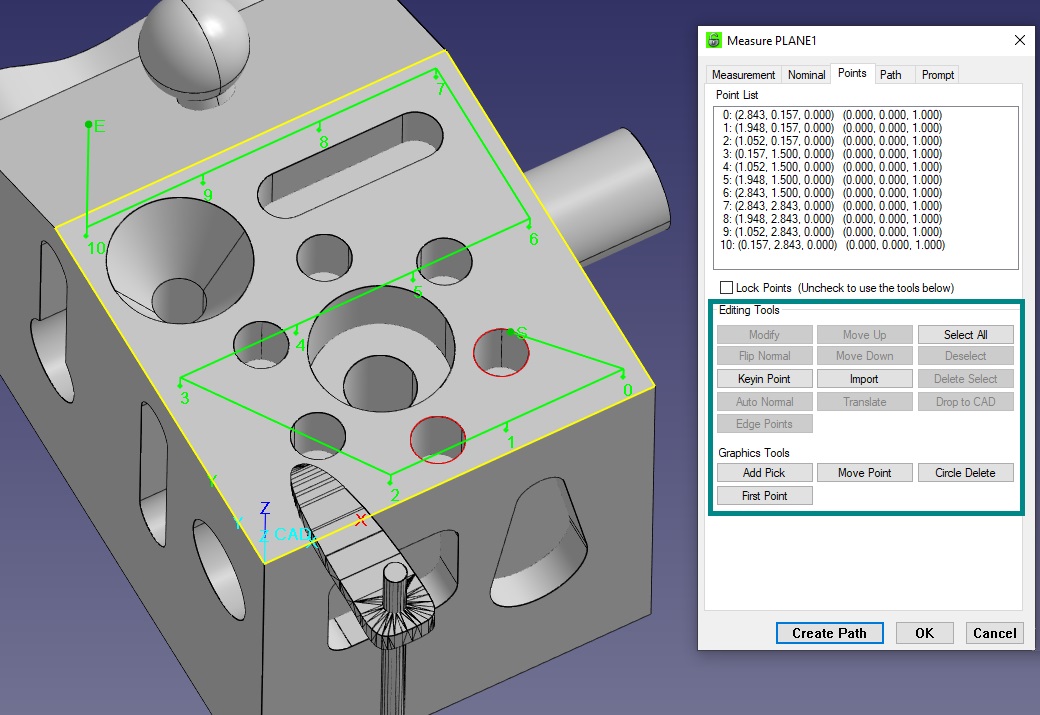

3.  Adjustments from Points Tab - Sometimes no amount of adjusting from the Measurement Tab will do.  In this case, we've removed one point by selecting the desired point and clicking the "Delete Select" button.  It is also possible to adjust points by keying in values or dragging graphically, adding points by Picking from CAD, etc.  As with the previous two methods, this works well with Path Planning as the link paths are recalculated automatically when dragging within program or adding new nearby features.

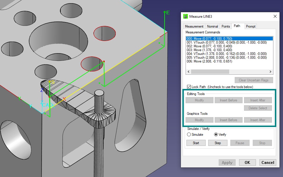

3.  Adjustments from Path Tab - While programming by Define Teach or Joystick Teach, it is common to use this method to add or adjust Probe Path.  It is not recommended to use this method when programming from CAD as the benefits of Auto Path Planning diminish due to "Locked Path" after adjustments are made.  In this case the "Locked Path" will prevent user from re-Creating Path in any way, extra mouse clicks are needed to unlock path, then any changes made will be undone when pressing Create Path on the Measurement Tab.  This method should only be used as a last resort for path adjustment.  If using this method, we suggest that you wait until the entire program is complete, thus allowing easy program sorting and editing before editing and Locking these individual paths.
