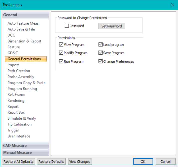

Enhanced Global Security Settings
- Prevent unauthorized program and software changes
- Globally assign permissions including:
   - View, Modify, Run, Load and Save Programs
   - Change Preferences
   - Option for password protection

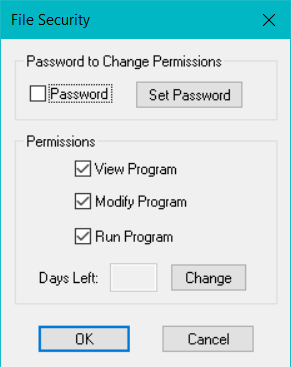

File Security
- Permissions to View, Modify, Run part program
- Password protection to change the permissions of a part program

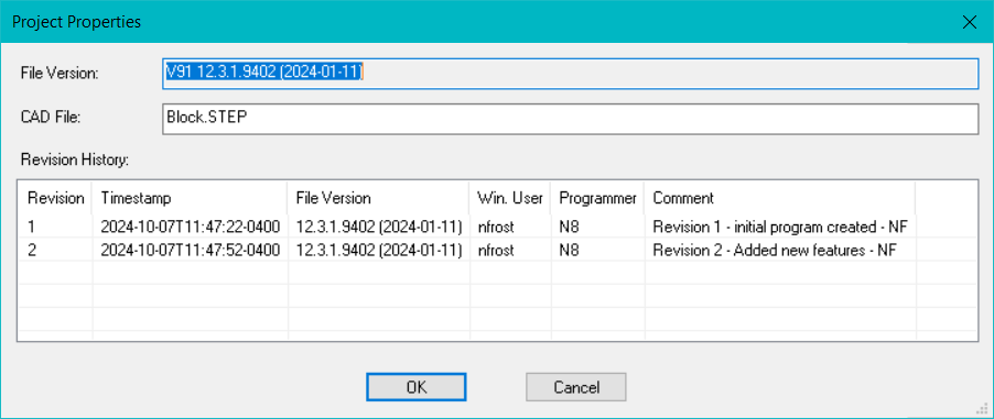

Project revision history is saved in file with optional comments
 -Track revision history of each CMM-Manager Program / Project file
 - Revision info is added automatically to Program or Project files during Save (As)

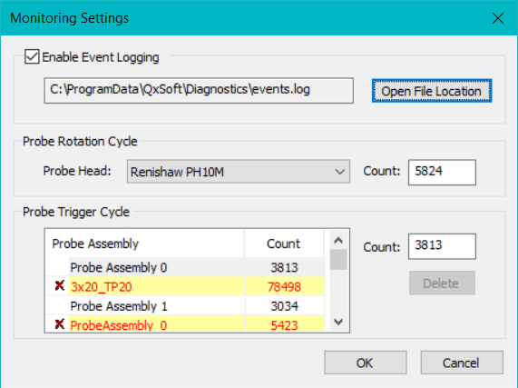

Monitoring Settings / Event Logging
 - Monitor events such as Program Start, End, Error, Application Open / Close, Tip Calibration status, etc.
Example Event Log Contents:
{"_timestamp":"2024-10-01T11:35:27.518-0400","Program":{"state":"stop","reason":"program execution error - user aborted"}}
{"_timestamp":"2024-10-01T11:56:14.446-0400","Program":{"state":"start","reason":"normal"}}
{"_timestamp":"2024-10-01T11:56:14.446-0400","Program":{"info":{"program_name":"Part4","programmer":"N8","company":"QxSoft","date":"Oct 01, 2024  11:06 AM","description":""}}}
{"_timestamp":"2024-10-01T11:56:27.784-0400","Errors":{"message":"Program Execution Error: Operation: '003 3-2-1 Alignment' Error: 'Operation cancelled by user.'"}}
{"_timestamp":"2024-10-01T11:56:28.883-0400","Program":{"state":"stop","reason":"program execution error - user aborted"}}
