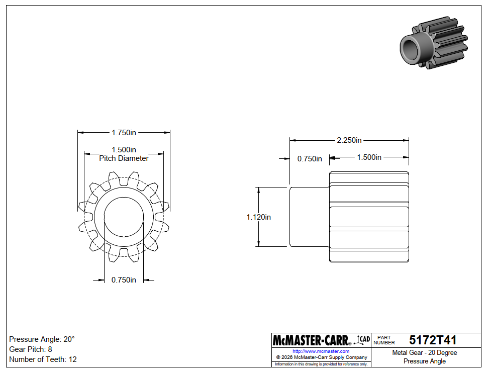

I uploaded a pdf file of a gear drawing.  Duck duck Go has something called duck.ai
I was offered many solutions for creating a CAD model from the uploaded pdf file from McMaster-Carr.
