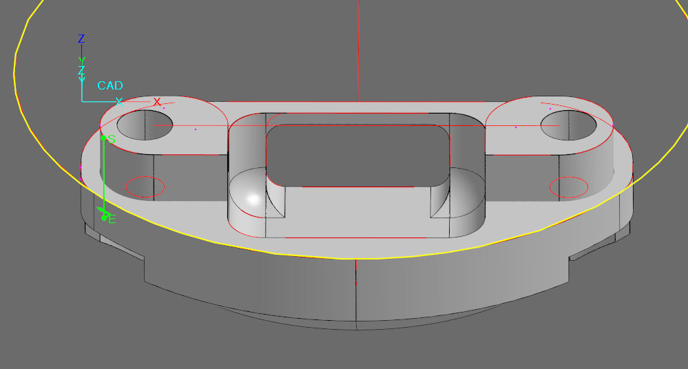

Is there a way to change the direction of a scan? Normally in this case, if my "arc" is segmented, so I choose "full circle" and adjust the range to measure the area I need. When I do this with a scan it wants to go in an undesirable direction. When I try to change the start point, it chooses the wrong direction again.
Also, is there a way to not have the approach/retract when scanning consecutive features? For example, it would be nice to have the machine continuously scan around the perimeter of the part, but end up with individual features.
