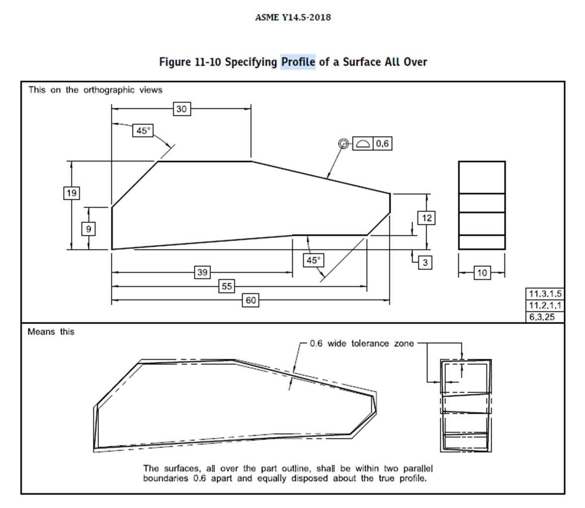

Hi CMM Manager Community,
Need some advice on this profile measurement below in red. What is the best method? This essentially measuring form per ASME Y14.5-2018. We keep getting erroneous measurements out of our CMM.
