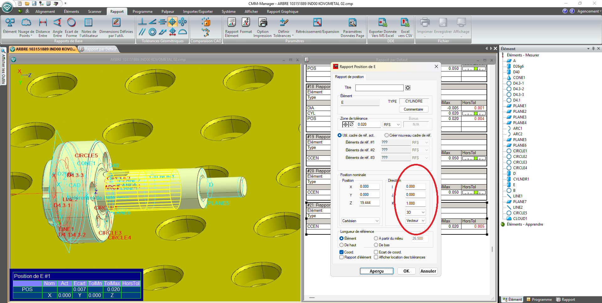

Hello,
I noticed a problem, but I don't know if it has already been corrected (I am using version 2022).
It concerns the True position of the cylinders.
I noticed that when values are entered in the “vector” section with the display set to 3 decimal places (0.000), the last 2 digits (0.00000) are always left visible and are not deleted invisibly, which affects the measurement results.
Below are the new values entered:

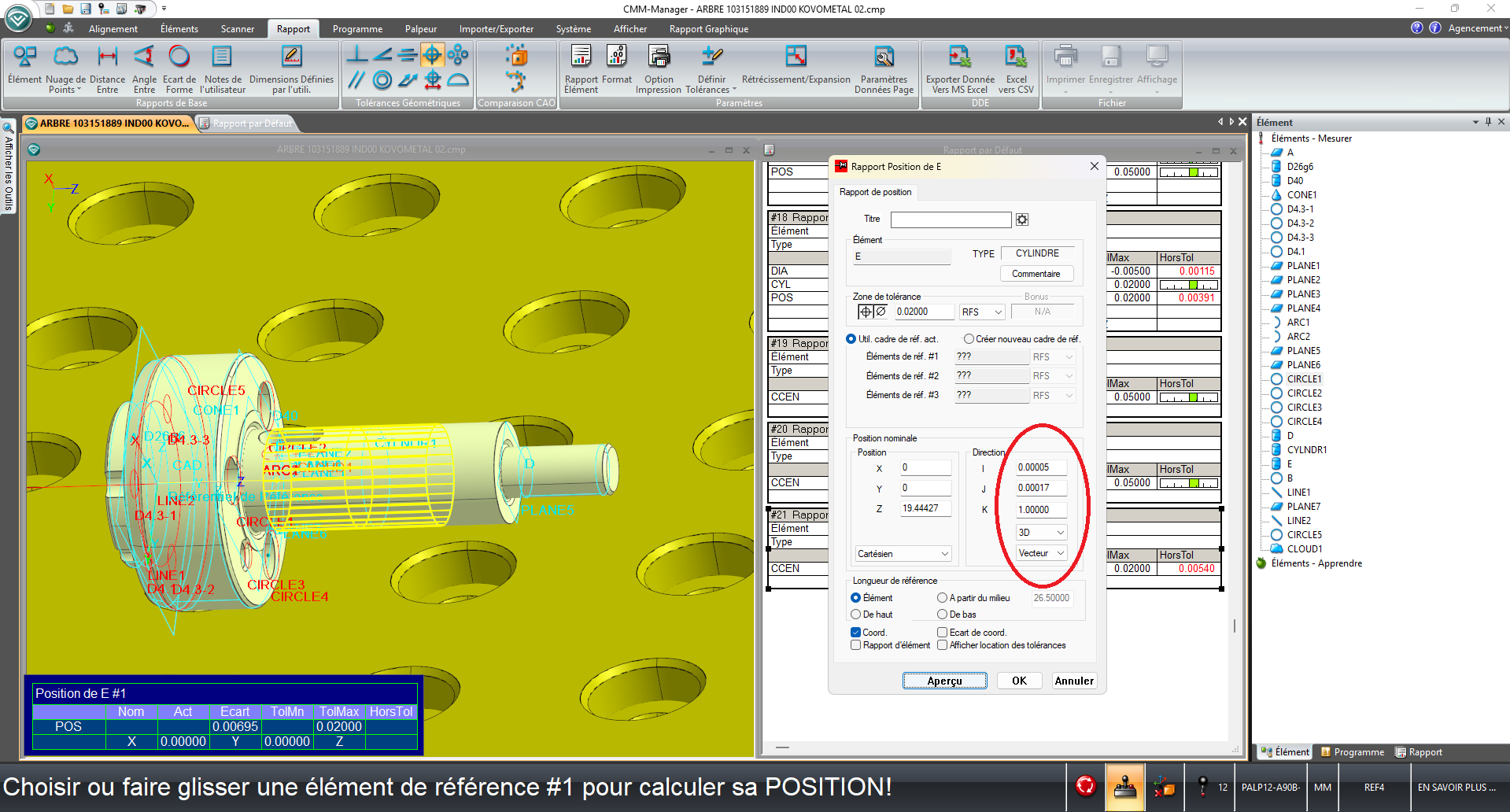

And now the display of values with 5 digits after the decimal point:

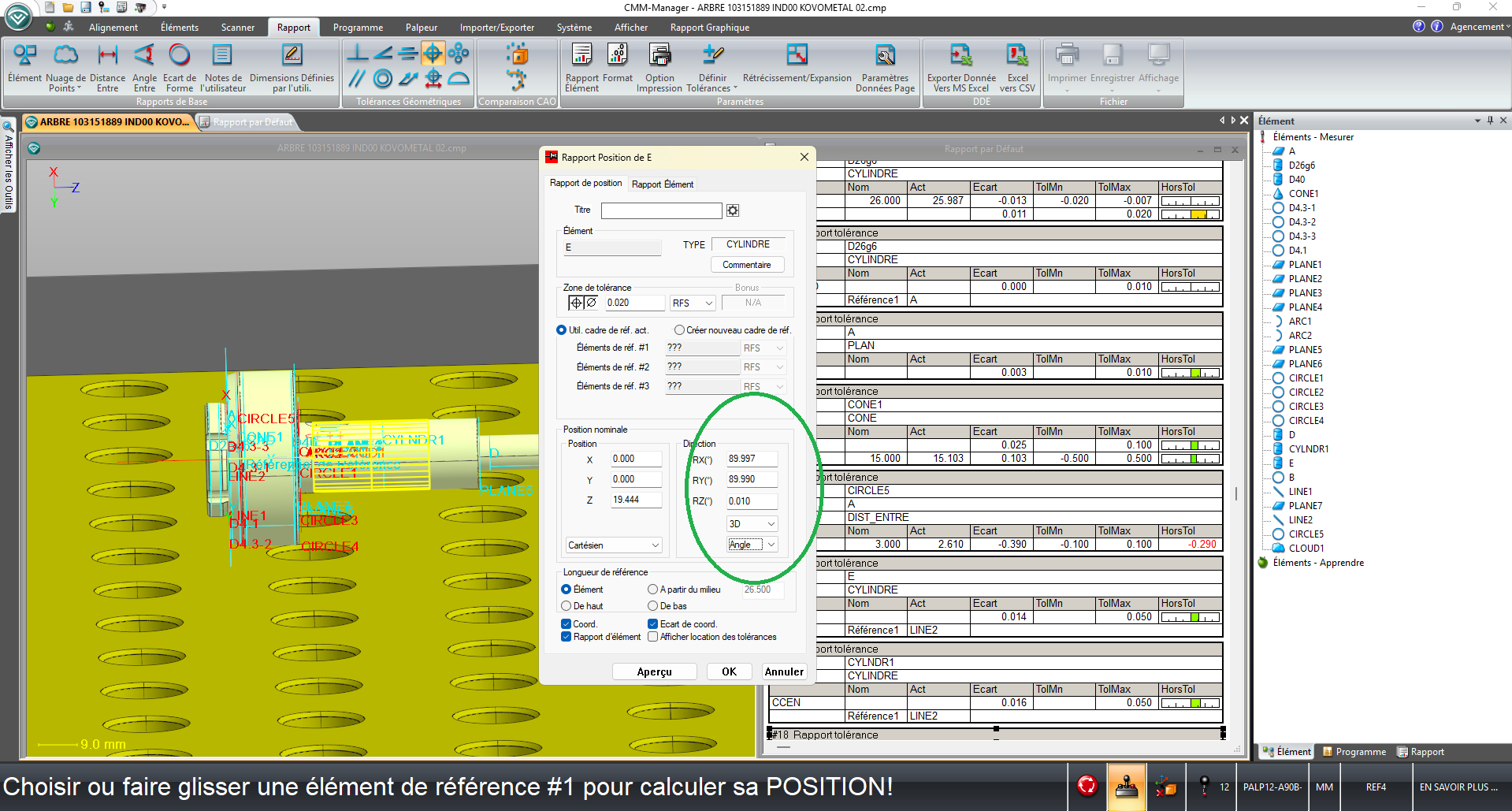

There is no problem if I set the mode to “Angle.”
