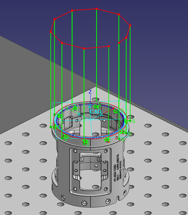

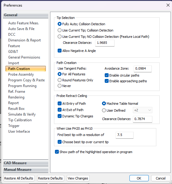

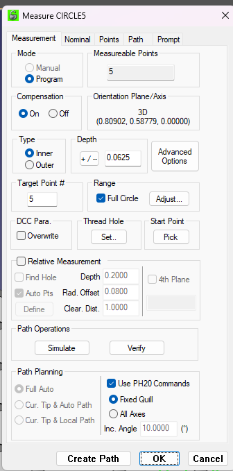

Finally got our new (used) machine up and running. We are new to the PH20 world and the first program I put in to modify with PH20 commands is showing some strange behavior.
I have dynamic tip changes selected, but the paths are wanting to go up to change angles. Is there another setting I need to look at?
