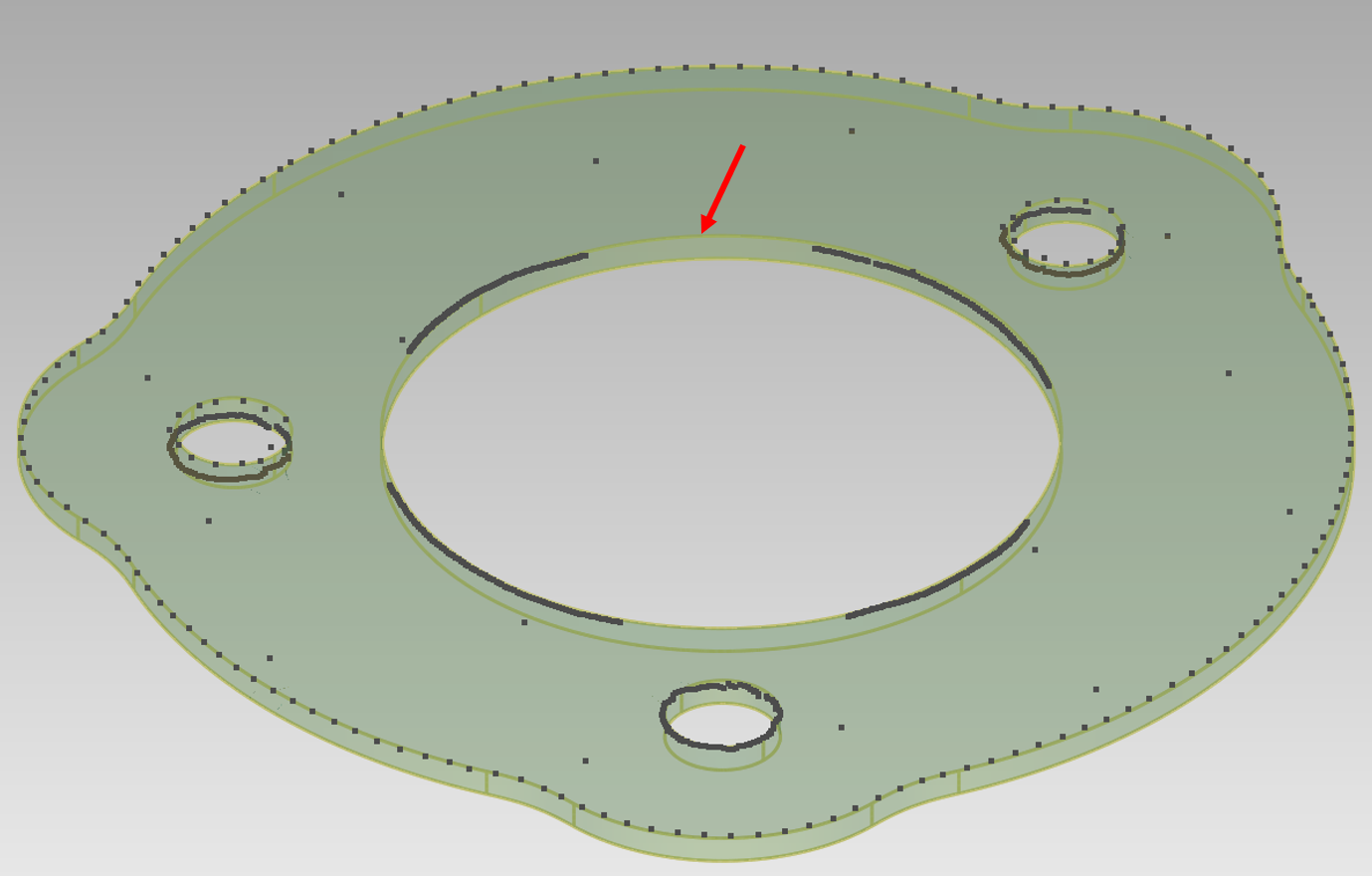

I've noticed that when measuring 2D vision CAD features and automatically generating measurements, only 4 measurements are generated (at least for a circle). Is there a way to automatically teach measurement locations that measure the circle's complete profile?
For example, when measuring the large center hole below, you can see that only four arcs were generated resulting in incomplete measurement data.
