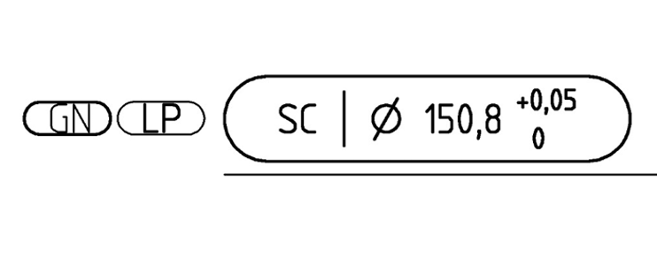

I need a bit of help regarding Circle meaurement and evaluation strategy. I have a cylinder feature that has the following requirements:
Currently the customer insists that we evaluate the circle Diameter as GN and LP
For LP (local point) is there a way in MCOSMOS-3 4.3.5 to get a result?
As far as i understand there is no standard evaluation method that correlates to this in MCOSMOS.
I would really appriciate any tips regarding this
