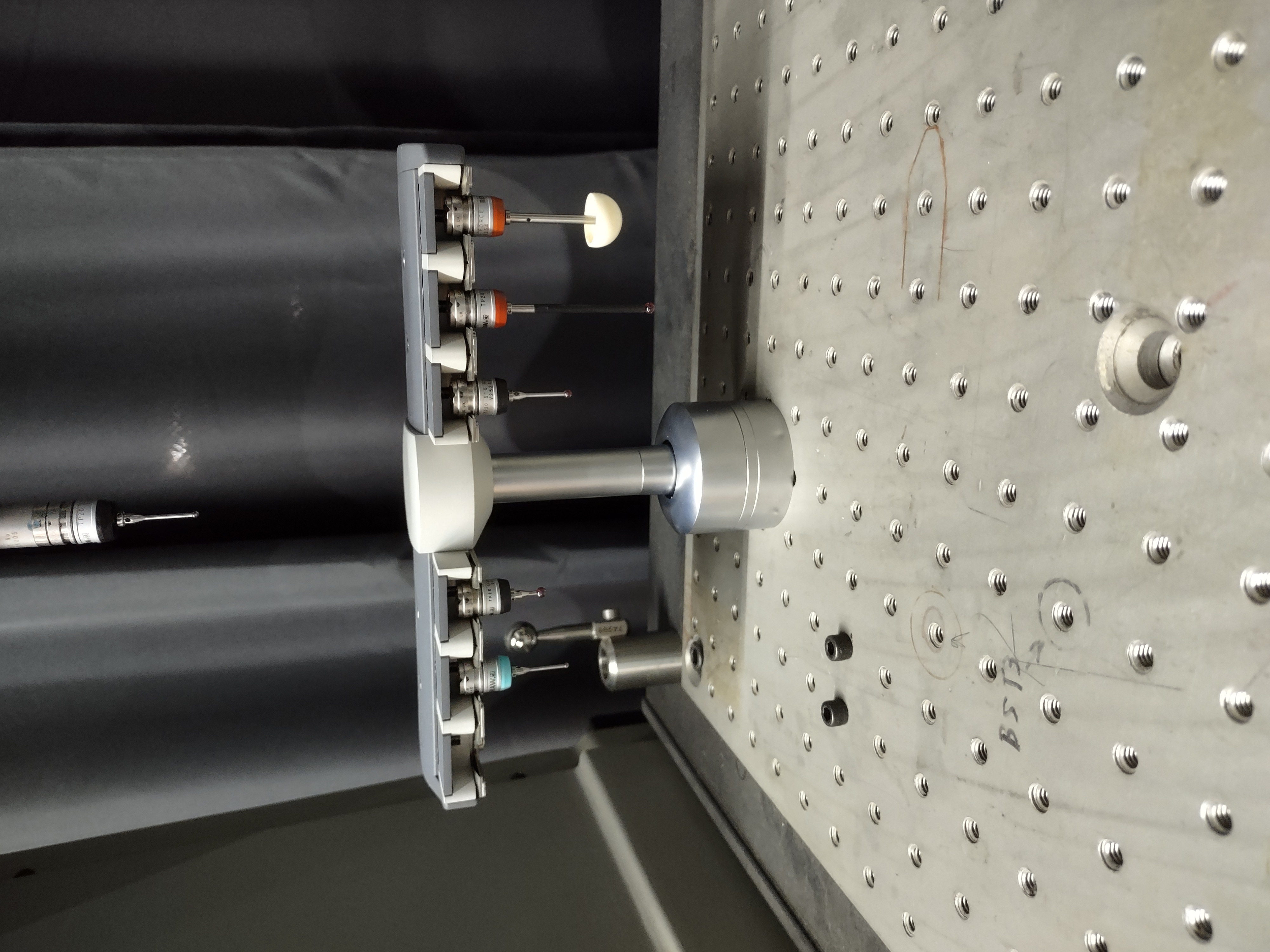

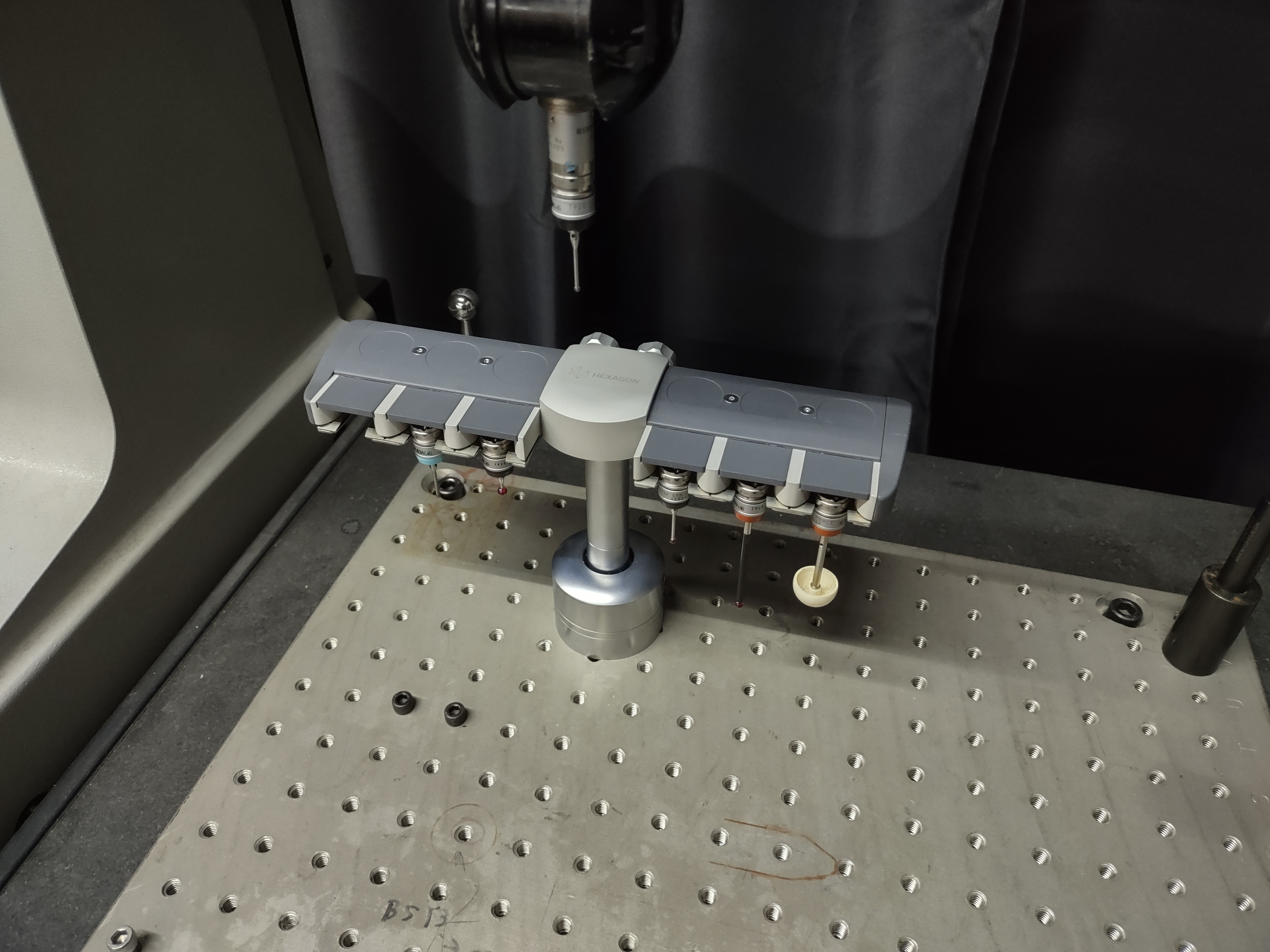

Hi all,

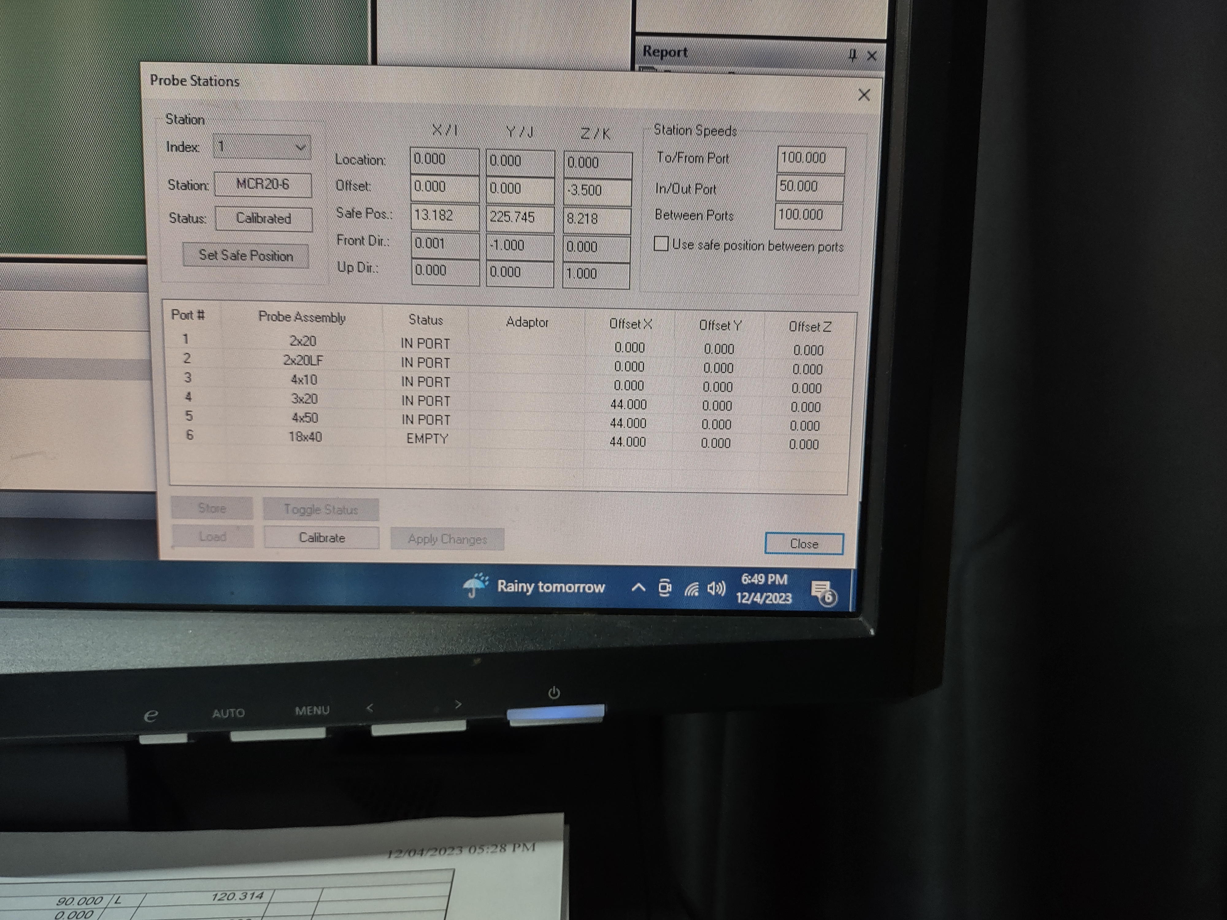

I recently acquired a probe change rack which is working perfectly with CMM-Manager as a Renishaw MCR-6.
I found this rack for $400.00 on a popular internet auction site new in the box.
Notice it holds TP20 modules just fine. I am not looking to sell it. I just thought some may find it useful.
