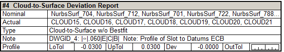

I am creating a csv file to feed into an SPC software that my current employer uses. I am using the GetReportInfo function to record the measurement results in a VB script. I have been able to use the CMM-Manager VB Script Reference Guide to pull the data from diameter measurements, Profiles, Parallelism, etc. but have not been able to figure out the Cloud-to-cad deviation code.

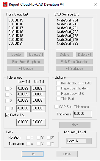

Here is a photo of the dimension, and the report info. I need to get the compiled profile deviation that is displayed beside deviation in the report. When inserting the reported feature name in the first area in quotations GetReportInfo( "1", "2", 3), I was able to pull the name directly from the report area which I also attached below.

This same approach did not work with the Cloud-to-CAD Deviation #4.
