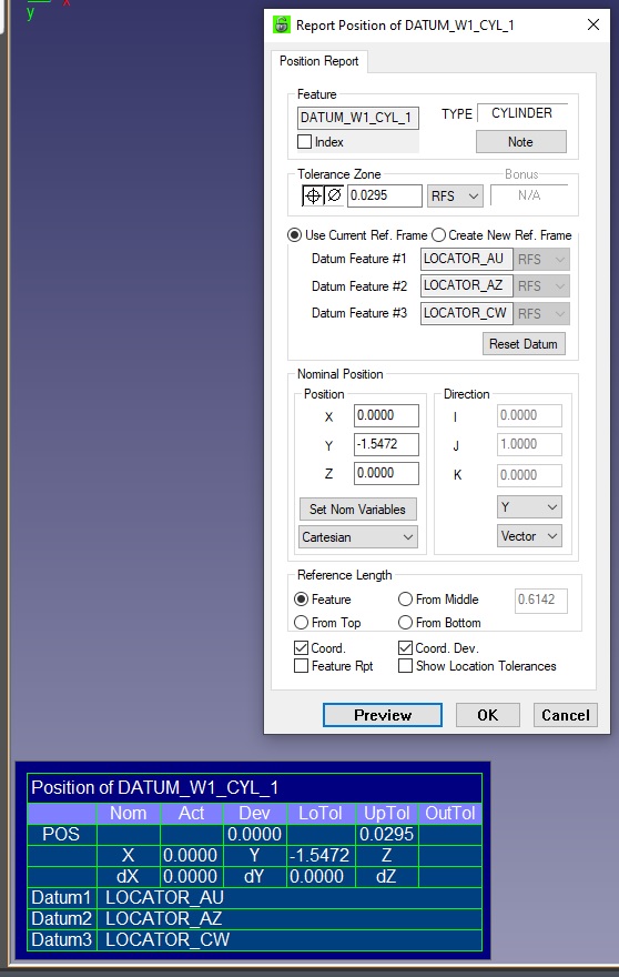

I am having an issue correctly reporting the true position of cylindrical features in CMM Manager 2017. Basically the reported position is in the wrong plane, reporting X-Y instead of X-Z position when the axis of the cylinder is in the Y direction and giving wildly out of tolerance position as a result. A circle defined from the cylindrical feature reports position correctly, but I need to use the projected length of the cylinder per the callout.
Is this a bug? Is there a way to get around this? Does this work correctly in later versions of CMM Manager?
Thanks!
