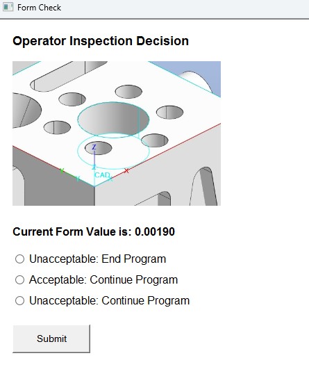

To create a dialog with an attached image
 by itself is not possible within CMM Manager and we must use a HTML code. The part must be aligned with a fully constrained alignment.
ISSUE: We need to measure CYNDR1 first for form. If that is not correct there is no sense moving forward. We will display the Form value then let the operator decide what to do next.
This is the end result.
I've attached the instructions below
It might be easier to copy the code from here Create a Dialog Box with an Image — CMM QUARTERLY instead of the .pdf
