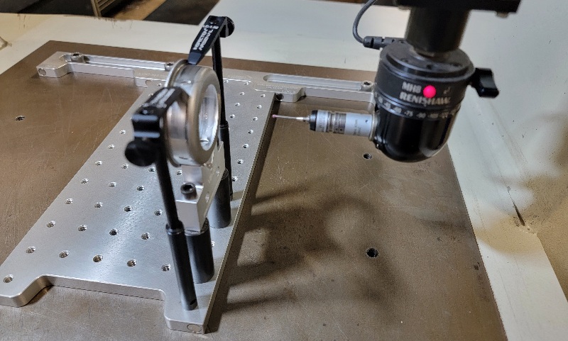

Clearance Plane – add the option to retract to the clearance plane at each touch point to avoid having to manually edit the path to avoid clamps and fixturing (defining  O.D.  measurement using DCC - see photo).
