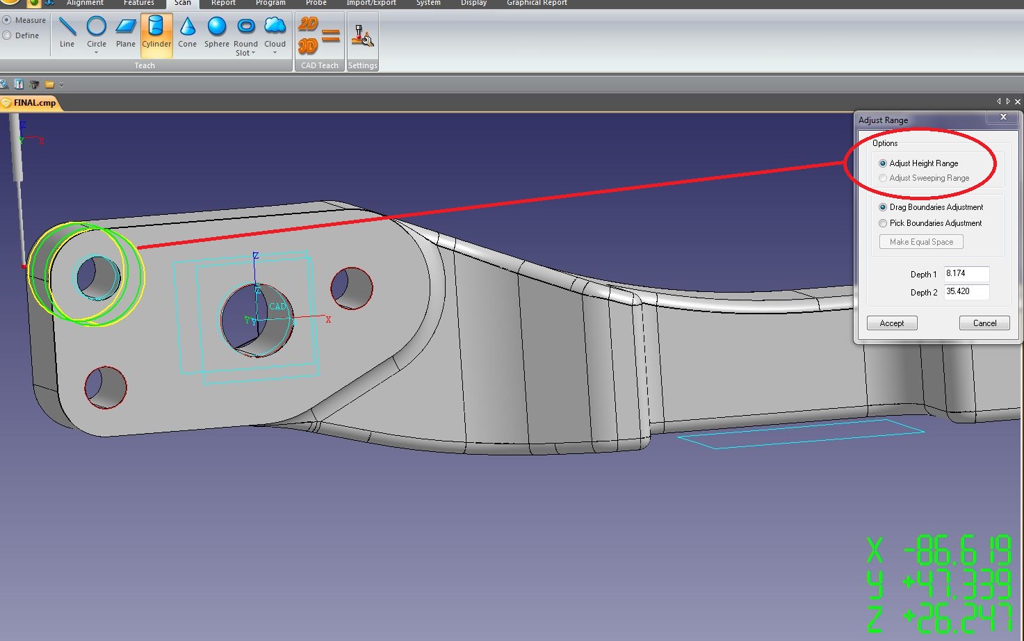

To the question, I am trying to get the scanning feature on this LK Nikon CMM with Renishaw PH10M Plus head to scan on half or quarter cylinders for when there is not enough room to do the full circle however I keep having the adjust sweeping range greyed out. Is this by design or is there a way to adjust it/make it available?
I'm just playing with the software as best I can to learn more and having never had access to CAD models or scanning before I want to learn as much as I can lol, I can get this cylinder to measure using traditional points by adjusting the sweeping range, but finding out if I can get the sweeping range on scanning to adjust would be helpful for other components.
